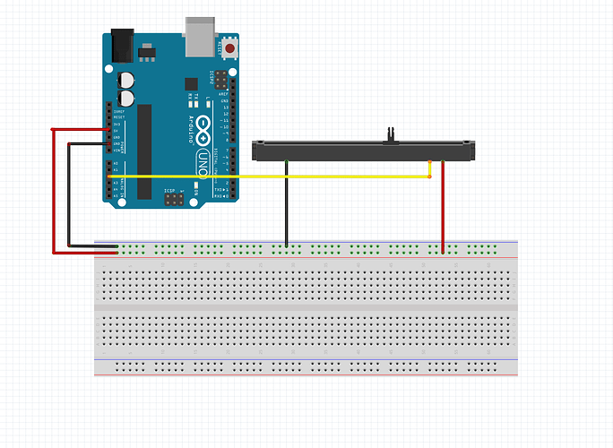

Read moreHi, I’m a newbie working on an arduino audio mixer slide fader, does this linear potentiometer work with Arduino?
Hi @Jenna273150
Welcome to the forums.
Yeah it will work ![]()
You can hook pin #2 of the slider to an analogue pin of your arduino and use the analogRead() method to pull a 12 bit integer (0 - 4095) which will represent it’s position.
I found this image for you. Note that the pins can be in different locations on different sliders.
