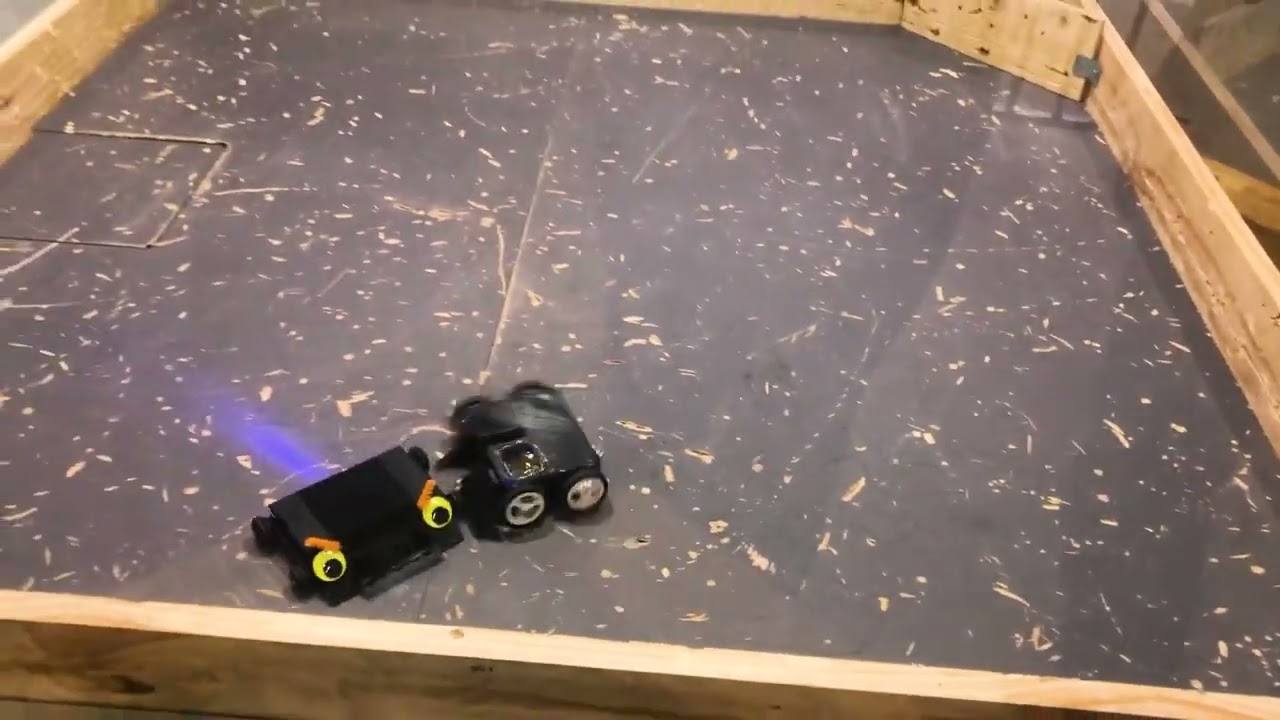

The game plan for Deadline was simple, try not to get too outclassed for the first two minutes of each fight, then once the trapdoor opens for the last minute try and bulldozer the other robot in for the instant KO. Below is the video of the first match where I identified the first issue, Deadline’s lid was still too tall in the centre so it can’t drive inverted! Fortunately my opponent Roz was kind enough to keep flipping me back upright so the battle could continue until the pit opened and we both fell in.

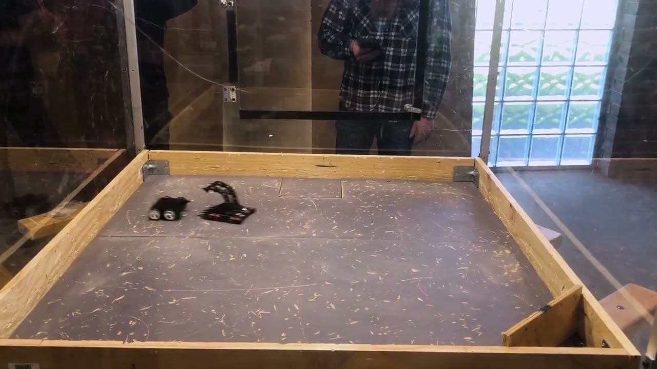

This fight is another example of the kindness of the community and the desire to just keep having a fun fight. My opponent (whose name I’m sorry I didn’t catch) flipped me into a helpless position position multiple times but continued to flip me right-side up again so we could continue rather than have me counted out and KOd less than a minute into the match.

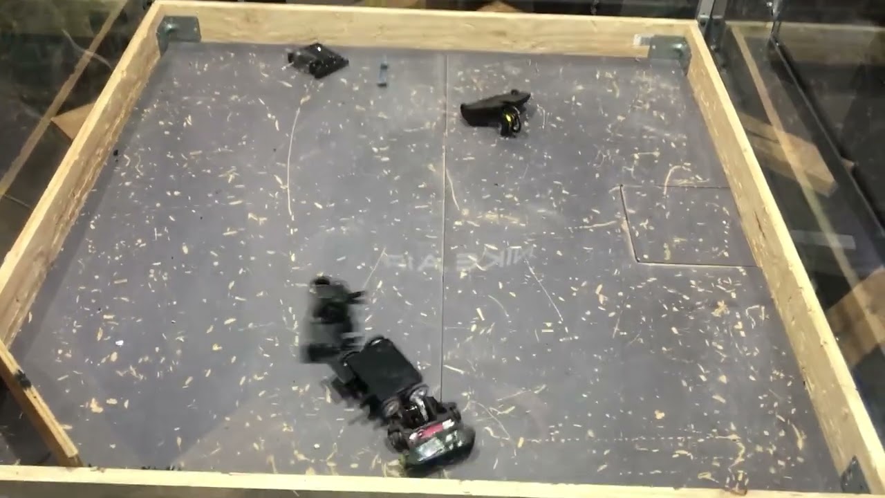

Since Deadline ended up fighting in the non-destructive division and was still fully functional at the end of our tournament it felt like the only right thing to do was to join in with the surviving destructive robots in their free-for-all rumble.
This bout was the biggest highlight of the next major design issue of Deadline, because it is has a square chassis if it can get stuck on its end with all four wheels spinning in the air. Fortunately the other drivers were kind enough to line up a free-hit and knock be back over so I could get back in the action.
