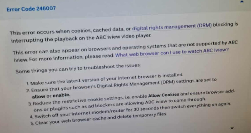

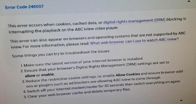

I am using a Pi 4B to stream free-to-air programs to a non-smart tv using Firefox. YouTube and SBS on demand have no issues, but ABC i-view comes up with an error (see photo of screen). I have addressed the probable causes (other photo) with no success.
I have tried both Firefox and Chromium, Trixie and Bookworm with no success. It is not an issue on my daily driver Linux Mint box. I note in the forum that this was an issue in 2022.
I have messaged the ABC in the hope that they may be able to provide a solution.
I’m hoping, in the meantime someone may have found a resolution.

I’ve not had this error on iView specifically, but I’ve had it happen before when trying to watch Binge on Ubuntu in 2020. Long story short is that the DRM module that a lot of companies use is designed principally for Windows and Mac. While the bigger companies have big enough tech teams to make sure everything works with a variety of OSes, I’m not surprised that some of the smaller Aussie Companies don’t.
There are ways to disable DRM in these situations. They’re very much skirting on the line of violating ToS and illegality, so we can neither link them here or encourage you to use them. But they’re out there.
Thanks Jane. I think I’ve found a workaround by using Libre elec. Currently investigating
