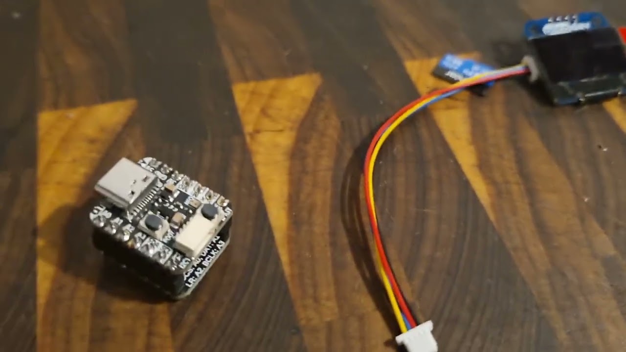

Goal
It’s all feeling like I’m on the wrong path entirely in terms of my build chain.
I will entertaining loading from SD onto flash first and reading from flash. ![]()
Nothing here is real time. 99% of the time this chip will be idle so I have plenty of time of read-write blocking code.
Thanks.
Pix ![]()
