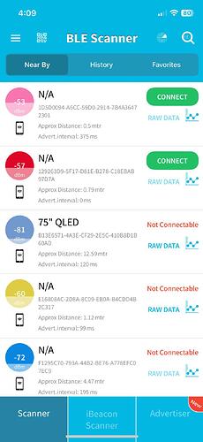

I am hoping to have my device sniff the various broadcasted BT or wifi signals from phones, head units, radio etc… that are nearby. so if anyone is driving past a gate or garage it can notify me. if i don’t have to have a normal BT module it is another saving i appreciate.do you have to do anything special to scan for BT classic signals from using the BLE? i have attached the example of what i can see from my iPhone BLE scanning app. There abit of info
