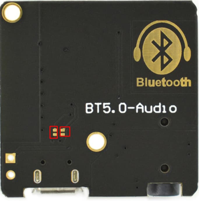

You have a few options for this, one would be using Bluetooth 5.0 Audio Receiver Board
and soldering the pads on the rear of the board together to convert it into a USB sound card.
