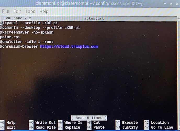

Second issue I’m running into is getting Chromium to load up on start. I’ve tried editing the global autostart file with Sudo commands in Nano and Mouse pad to no avail. I also created a directory under home/pi/.config/lxsession/lxde-pi/autostart
I obviously kept th first three lines in that autostart as per the global but yeh, doesn’t even seem to do anything on start up. Starts up fine but don’t see it trying to load chromium even with a basic @chromium-browser command in the autostart file.

Yeh after reading a lot of stuff I realised that too re. GUI and I understand the concept around running a script and could definitely manage that. However im at the point now where I think I might need to reinstall the OS on the card and start from scratch. The autostart isn’t working as it should at all. Global autostart file won’t work after Sudo editing it and even creating the directory and autostart file in /home/pi/.config/lxsession/LXDE-pi/autostart doesn’t work…Am I correct in understanding that if this directory exists with an autostart file in it the system will prioritise that instead of the one found in /etc/xdg ?

Based on what you’ve described. I’d reckon there’s a missing read permission on your autostart file that you’ve got set up at the moment depending on which user you used to create or edit it. You can probably use ls -la to check the bits, then sudo chmod a+rwx autostart or a similar command to fix this, although starting from scratch is probably easier imo.

Copied the autostart folder from etc/xdg to ~/.config/lxsession/LXDE-pi
Edited that file with nano exactly how you said and it still won’t autoboot the browser. Tried the same commands but with chromium-browser and without --kiosk just to test. Still nothing. I’ve also tried --kiosk --start-fullscreen and used https://wwwgoogle.com to test as well with no luck.
How unusual, can you please try running ls -la on the autostart folder? Curious to see what the read bits are set to.
Also, you shouldn’t have an @ at the start of lxpanel on the first line, I’ll have to double check but I’m fairly sure in this context that runs it as a background task.

Can you please run the following two commands:
~ $ cd ~/.config/lxsession/LXDE-pi/
~/.config/lxsession/LXDE-pi/ $ ls -la
First is a cd or change directory, into the LXDE-pi/ directory where autostart should be, and the second is ls or list directory with a couple flags on which basically just make the output more verbose so we can see those bits. If they’re not what we’re expecting, you can just run chmod or change mode to update those permissions, you may need to do this as superuser so I added a sudo or superuser do at the start:
Which will add read-write-execute permissions for all users to the autostart file so we’re certain users with any permissions or groups can read/run it.
All we need to do is check that autostart has r in the right spot in those permissions on the far left so your user can actually read and run it when logged in.
