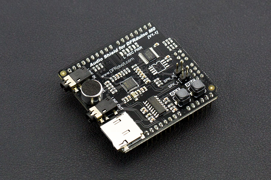

Just got the audio shield and matching dfrobot m0 board. However the combo refuses to recognise any sd card I use, they’re all 16gb, fat32 formatted with the official sd card utility.
The sd pin is set to 30, the board is recognised and sketches can be uploaded. I’ve also tried a larger power supply, resets, even made sure that the sd library selected the correct clock etc pins. All sketches tested have been those supplied by dfrobot.

Could you please upload the sketch that you are trying to use? Just to confirm, you are using the Audio Shield For DFRduino M0 SKU: DFR0420 ?
