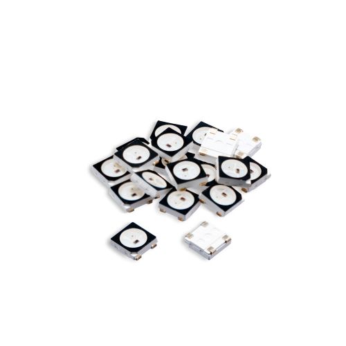

This is a placeholder topic for “GlowBit LED 20 Pack - Black (WS2812B v5) NeoPixel Compatible” comments.
A perfectly sized pack of vibrant SMD GlowBit LEDs ready to be used in your PCB designs!
