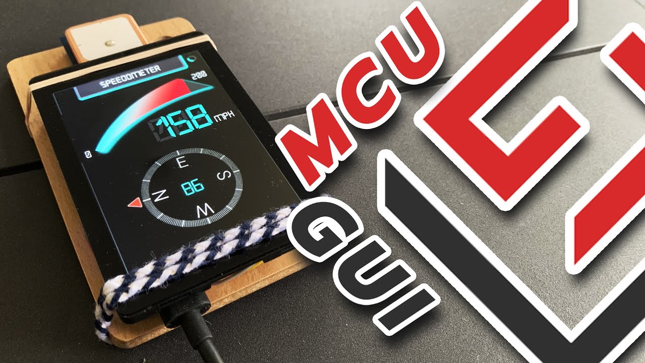

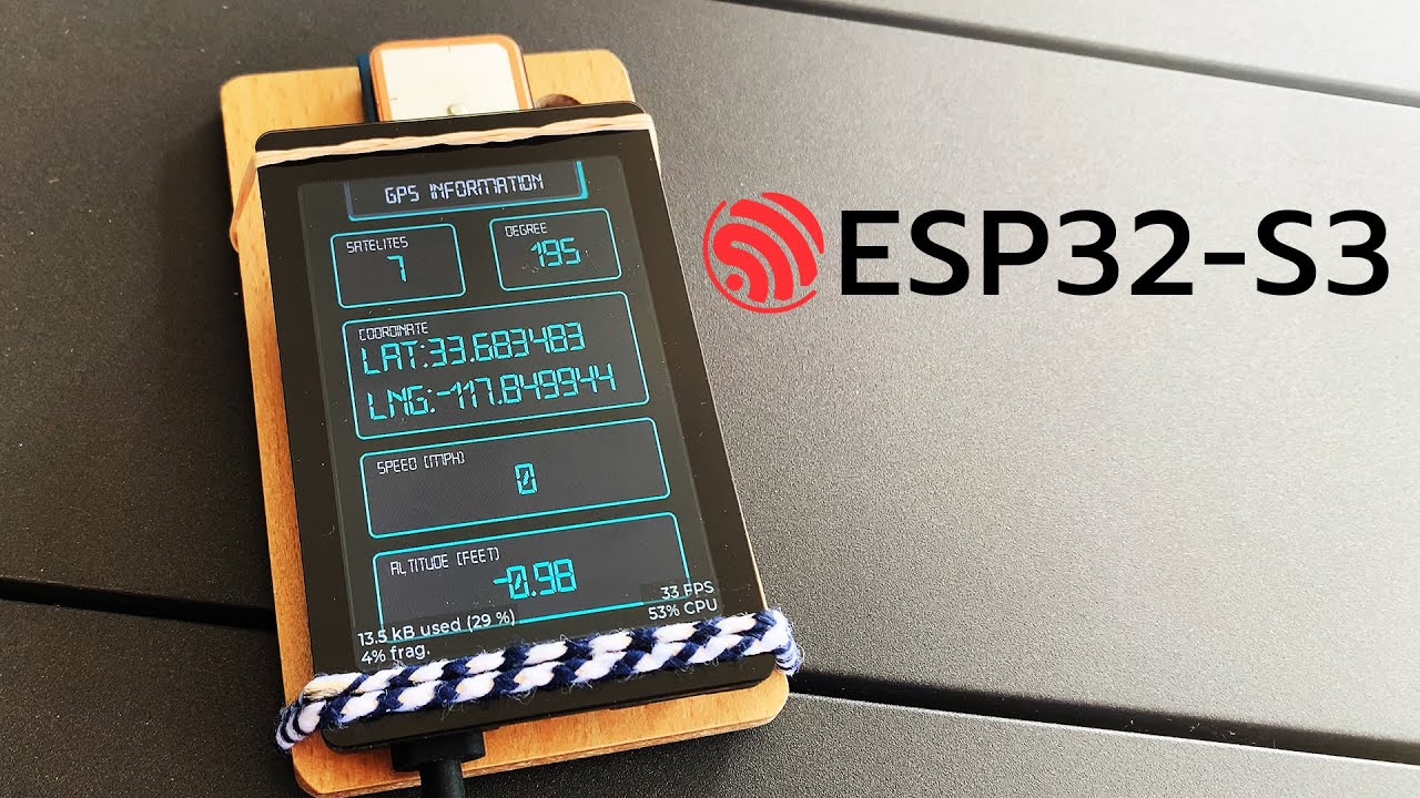

Another way that looked interesting was using a ESP32 Development Board WT32-SC01 Plus with 3.5in 320 * 480 Based on ESP32-WROVER-B Multi-Touch LCD Screen. This has bluetooth capability so I am thinking build a standalone module but then run a bluetooth link to the Pi.
Big ideas but probably filled with coding nightmares.

Hi @Stuart270792,
If you don’t have much experience with coding, it’s probably better to go the Python / Micropython route. It is a much better learning curve than any other coding language.
The wiki for the USB/TTL Raspberry Pi GPS Tracker includes some sample code on getting it to run with Python so it seems like a good choice.
My big worry with you using the ESP32 Development Board, however, is just that while Micropython can be used with it, its nowhere near as well supported as C++ is on the Arduino. I’m sure you could hack something together though, it might just be a bit more complicated.
