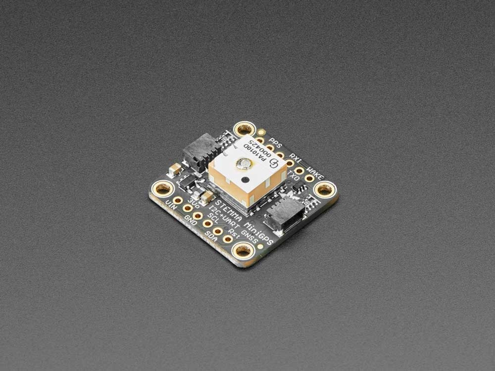

Thanks Andrew, I will check that out. I was just looking at another GPS from Adafruit when you sent the message: https://core-electronics.com.au/adafruit-mini-gps-pa1010d-uart-and-i2c-stemma-qt.html.

Thanks Liam, I am using Pi Juice in the mix which does the RTC part so I am not worried about timing part. Now that I know that a hardware GPS collection module will be required, we are looking into any module that is easy to integrate without i2c coflict, can work with Pi zero and works within 3.3-5v.
If there is no external antenna, and we need to put the GPS device inside an enclosure, is it going to play up?
We are now considering getting one of these two:
One of them (Sparkfun) has an external antenna, while the Adafruit doesn’t. I checked on Adafruit website, they have illustrated Pi integration so i am sure it works with Pi. Sparkfun should as well. Any opinion on these two?
Depends what the enclosure is made of. If metal it probably won’t work without an external antenna.

Thanks Bob, it is going to be PLA.
