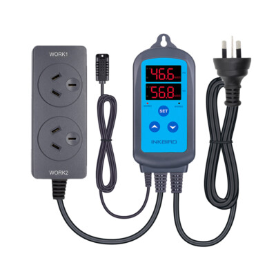

I have zero experience with controllers and dont know anything about them. Here is a link to the inkbird. You set the parameters, plug in your devices and thats it. Heres the link for one on ebay.

Thanks for sending that link through so we know exactly what product you have and don’t need to guess between a few similar ones.
We don’t have any controllers like the Inkbird that will control mains-powered devices for you, we provide parts and advice so people can build their own devices which means we deliberately steer clear of anything with dangerous voltage levels.
Perhaps you can find some sort of “smart” powerboard elsewhere and build a device to send commands to it, but we won’t have anything that replaces the Inkbird right out of the box and doesn’t require some tinkering and programming to build.
