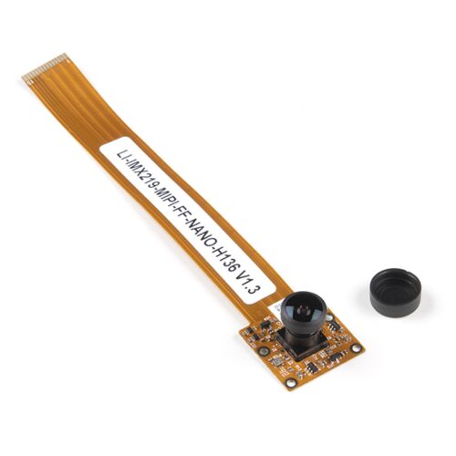

This camera appears to have a 15 pin connector. The Jetson Orin Nano has a .5" 22 pin connector.
Hey @Nigel164388,
You are correct, this camera suits the original Jetson Nano-style 15-pin CSI connector, but it won’t work with the Jetson Orin Nano’s 22-pin connector.
If you wanted to try it with the Orin Nano, you’d need something like the 15-pin to 22-pin camera cable joiner. Just take care with ribbon orientation and pinout before powering up
Yes I have ordered the afaptor, the camera and then a cable combo I think will work with all the Orin Nano.
