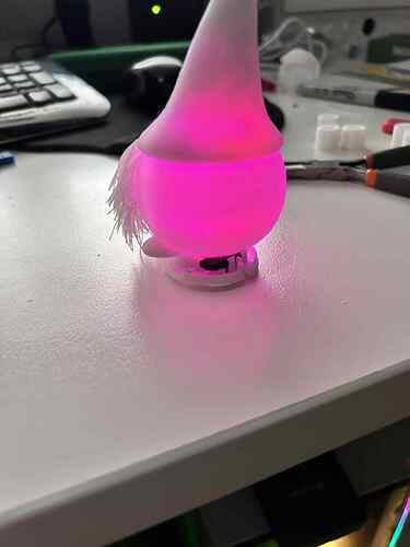

I am confused somewhat. needing to make a switch with battery and lights this is going inside a 3d printed item similar to the pic.
. Wanting multicolour not just red blue green. What parts do i need?? Or do we need arduino?

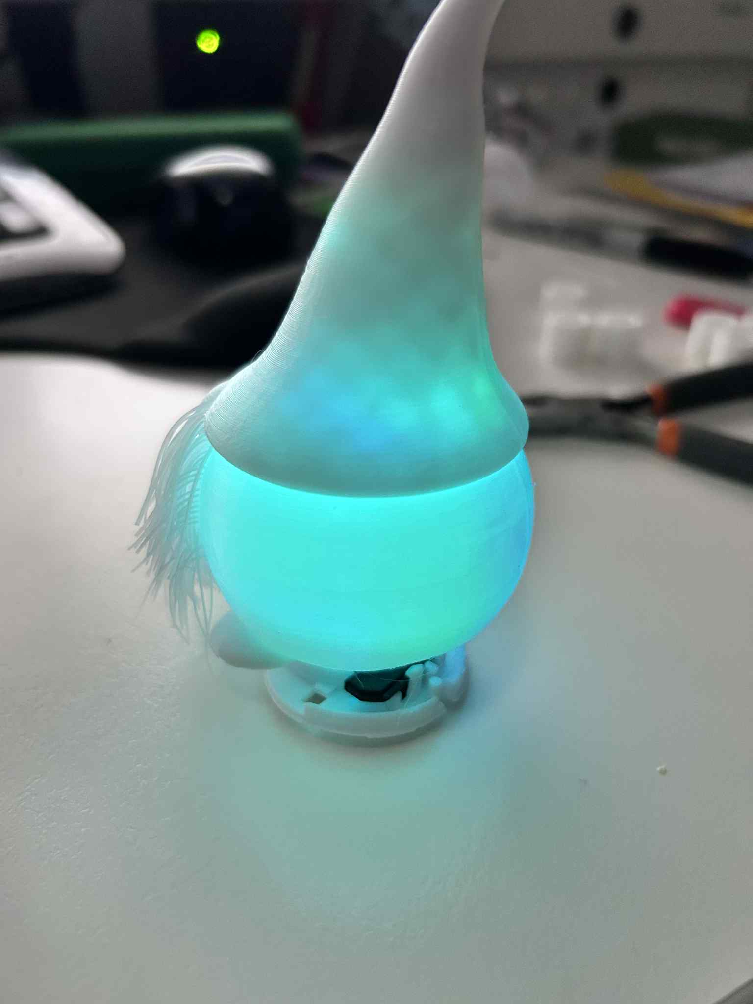

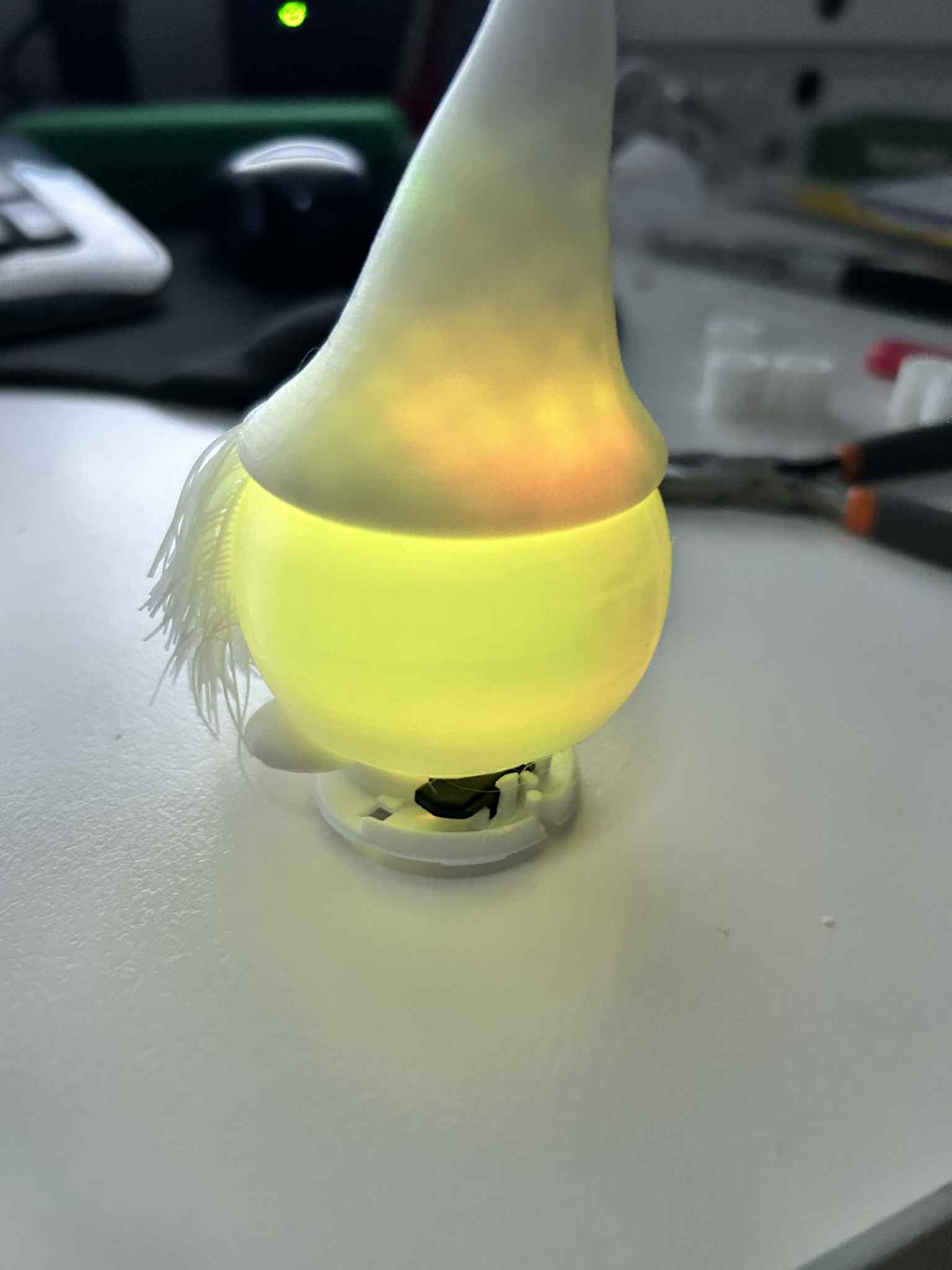

I pulled the tea light i have apart to find there is no pcb board. Looks like a switch and a diode. but the diode has multi colours not just red blue green. where would i find the diode that has like this and the switch. Im not good at this trying to learn.

I’d imagine an LED like this is being used in the board listed: https://core-electronics.com.au/led-5mm-cycling-rgb-slow.html
