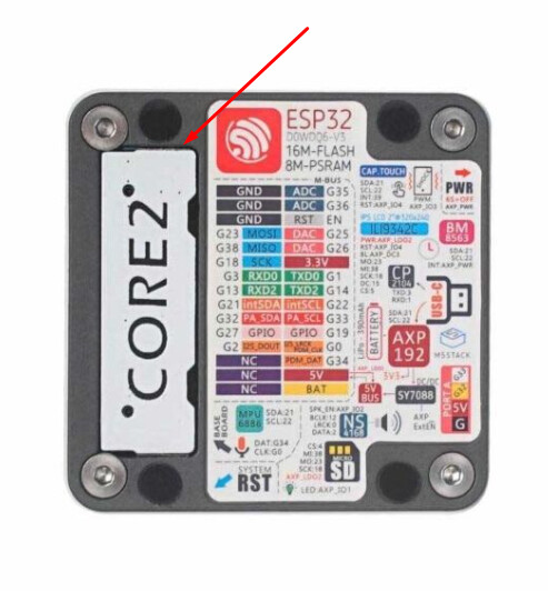

Read moreHow is the gpio made available in the M5Stack Core2 ESP32 IoT Development Kit V1.1
Hey there, @JW160152, it’s accessible under this part of the M5Stack:
This port is fitted very tightly with a male 2x15 header set directly into the board’s female headers, so if you want to use these headers I’d probably suggest leaving it off or making a different cover. Note this would disable the Grove port on the side, which exposes 5V, GND, GPIO32 and GPIO33. for easy i2c communications.
