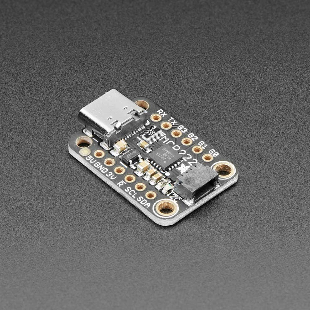

Making PiicoDev compatible with the Adafruit MCP2221A Breakout
I asked Claude to make PiicoDev_Unified.py compatible with the Adafruit MCP2221A Breakout and the fix was surprisingly simple.
Changes to PiicoDev_Unified.py involved a new I2C class to wrap the pre-instantiated SMBus compatible class provided by the Easy MCP2221 library, and an extra few lines of logic in the create_unified_i2c method.
I’ve tested it with the buzzer, aq, and atmospheric pressure sensors so far, and it seems to work fine.
Modified code if anyone’s interested.
