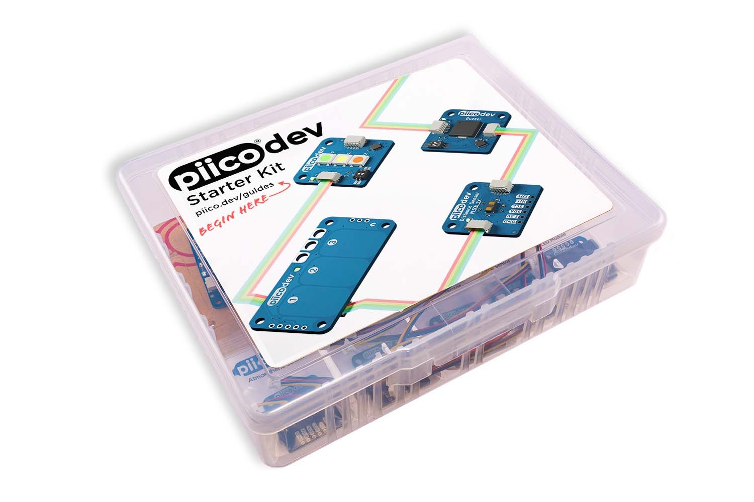

As for a kit that includes those sensors for easy use with a MicroBit, I’d have to suggest the sensor kits that we’ve started manufacturing here in Newcastle for our PiicoDev range which we support and program libraries for (all hardware and the scripts we release are publically available on the matching GitHub repositories). They’re not available on the site just yet as a kit but will be soon and in the meantime, the parts from the kit can be ordered individually to make up most of what you need:
These guides may be helpful in figuring out which parts you’d find most suitable for the projects that you’re looking to do with your students. For some small motors, I’d suggest some micro-servos. Something like an SG90 should work well. And for a touch/UV sensor a switch and a micropython supported I2C UV sensor ought to work nicely.
