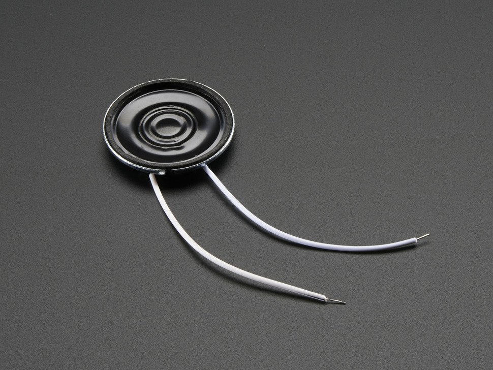

For a speaker you can use this:
or this if you want more volume:
These will all work with the Microbit, to connect them you could use a combination of these two types of alligator clips:
