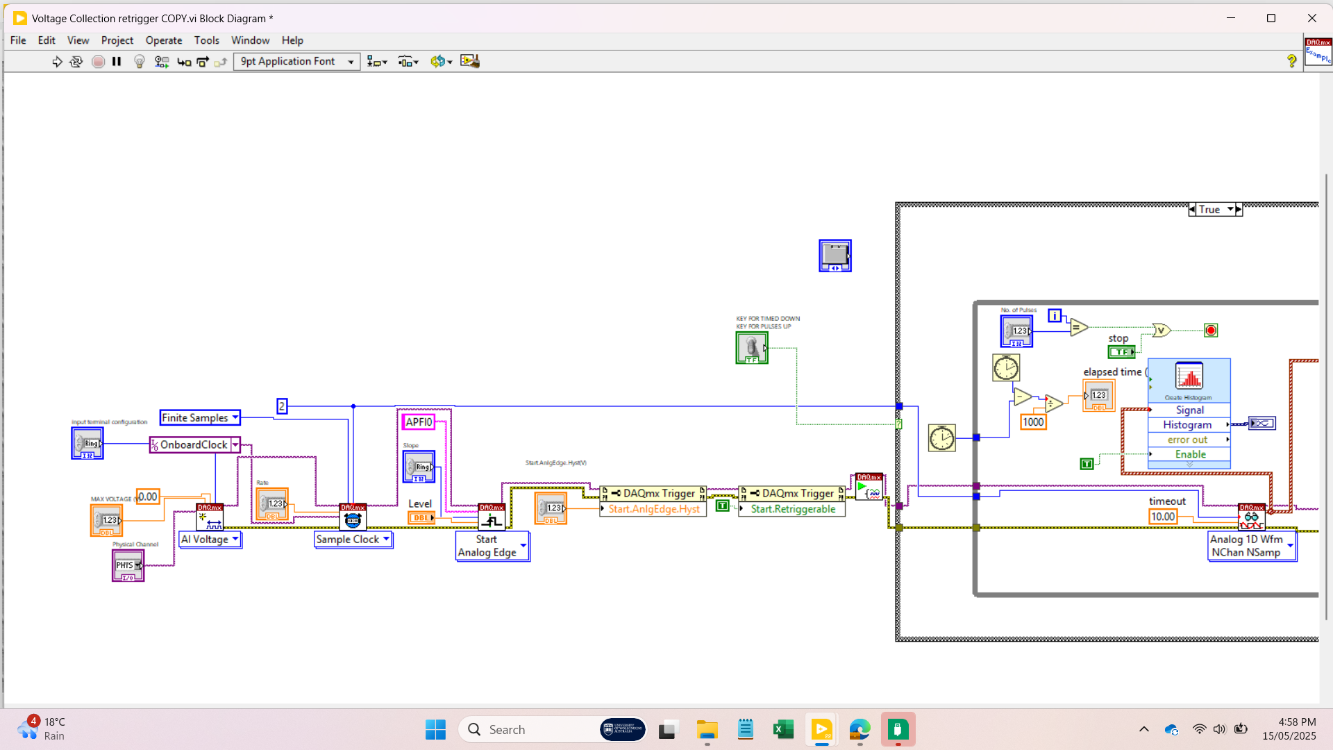

I apologize for the interruption. I am currently working with the NI 6363 DAQ system and employing a retriggerable acquisition approach. However, I am encountering a consistent transient behavior in the initial captured data points.
To address this, I connected a unity gain buffer, but unfortunately, the transient behavior still persists.
I would greatly appreciate your guidance, as I am currently stuck on this task and need assistance in resolving the issue.

Set AIConv.Rate manually to reduce channel switching frequency, allowing settling:
daqmx_task.Timing.SampleClockRate = 100000  # Example: lower than max rate
Alternatively, configure the AIConvert.MaxRate or AIConvert.SettlingTime property if available.

Thanks for your reply…I attached my code image
this option is not available
