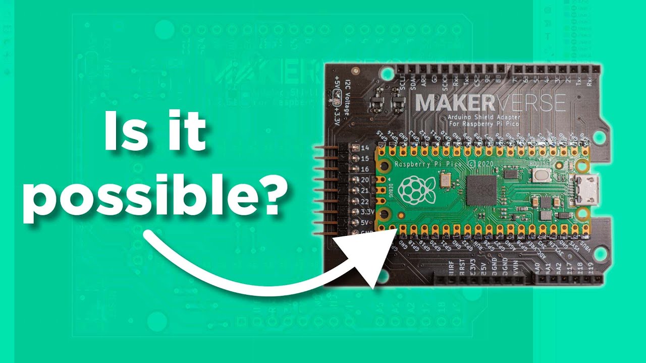

New video! We’ve a bunch more prototypes to discuss this week in The Factory. We’re coming face-to-face with the challenges of backwards compatibility: Fitting a 3.3V MicroPython board into the footprint of the 5V Uno. We’re also migrating to KiCad 6 with quality of life improvements and panelisation now just a plugin away! We look at a tiny Makerverse Class-D amplifier and test jig, perfect for adding a low power and footprint audio solution to your project, and finally we talk the early development stages of a MicroPython E-textiles & wearables line, let us know your thoughts on the features.
Amazing idea - Many Makers already have various Arduino Shields that could then be used with Micropython.
Adding level shifters for more/all digital I/O could minimise 5V/3V3 compatibility problems…
Using a standard socketed Pi-Pico could be useful - would allow one to replace the Pico when things don’t go to plan… maybe there is a market for both Pico-socket and RP2040-on-board versions? (Same board with both pad options?)
Adding a PiicoDev connector as part of the additional IO and a Reset Button would also be a useful option.
Thanks for the suggestions, I’ll let the production team know about the post for you to see whether we can incorporate/further discuss the ideas that you’ve brought up.
Great suggestions @Victor153764. We’re turning over ideas for how to do the logic-level shifting. It’s turning out to be non-trivial!
The challenges:
low-impedance outputs that work at 5V so you can drive higher-current loads like LEDs. There might be some compromises on what’s possible with output current.
allowing external pullup resistors for using with eg. buttons. Logic level shifting circuitry can foul the behaviour of the pullup resistor since the LLC could be low-impedance output. The pullup resistor may never be able to fight the LLC. The solution is to use internal pull-up / -down only, but that kinda sucks to gate the user from creating their own pull-up/down circuitry.
