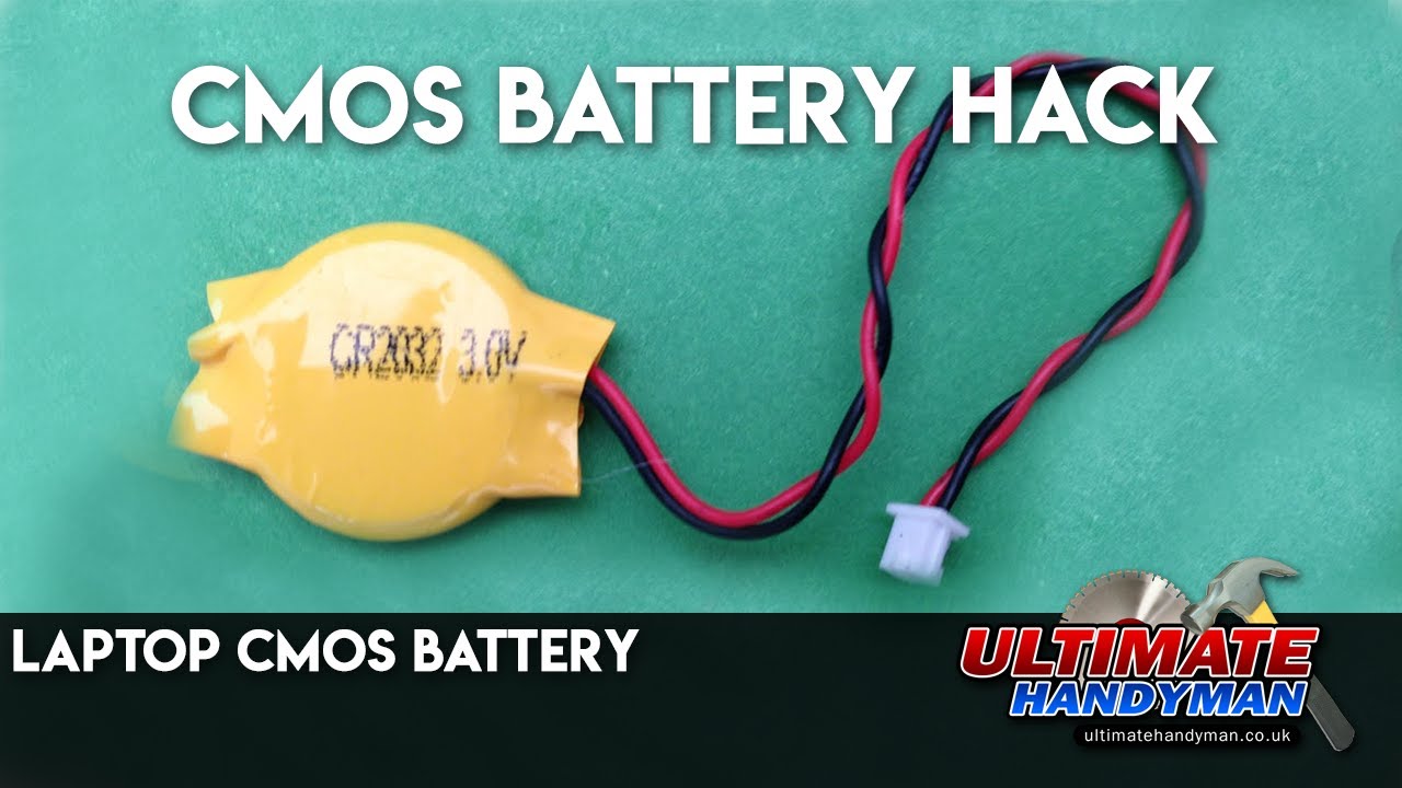

What is thrown a spanner in my works is the gender of the cable connector.
Male of Female?
So I may have to pull it apart to find that out in the first place. :frowning:
Does core have/sell the battery (with leads) pre-built?
Like this:
And what type of connector is at the end?
Hey Andrew,
To my knowledge, Core Electronics doesn’t sell a cell like this, I’m assuming that’s just a CR2032 in there? As you’ve probably already seen, all of the sleeves and battery holders for the CR2032 are typically designed to either fully encase the battery, or are designed to be soldered directly to a PCB
Hard to tell without knowing the pitch or dimensions, but compared to the size of the CR2032 in that image, I’d suspect that’s a JST connection, probably JST-PH, but you’d have to get the measurements and check the keying on it to confirm. Here’s a fairly extensive guide for how to identify it:

I have encountered this in several computers (I fiddle with stuff older than 20 years sometimes). I cut off the plastic shell, you’ll find the leads have tabs that are spot welded to the battery. I get a stanley knife blade pushed against the weld, give it a sharp tap with something, pops the weld. There are usually two welds per lead. Then bend the tabs a bit so they have a bit of spring. Then electrical tape the leads to a new CR2032, binding the tape tightly. Although there is nothing more than the tape pulling the leads in contact with the battery, I’ve not had a failure and some are years old.
