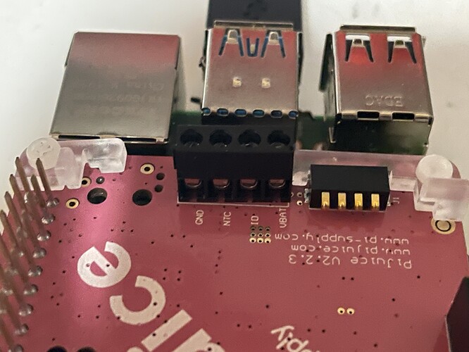

Out of the box the battery it came with ‘BP7X_1820’ is also not connecting to the Pijuice. It looks perfectly fine as well as the pins on the PCB of the Pijuice - but it still says under battery status NOT_PRESENT.

The battery is @ 3.94 volts, I have also attached a photo of the pins.
I have also taken a photo of the connections. I have also removed the Pi hat and reinstated multiple times, and even checked if I am getting power from both rail power GPIO pins.

I also just rubbed the copper on the LiPo battery roughly and now it appears there is connection established to the board and the LiPo battery. I am getting a slow pulsating green light on the PiJuice while the Pi4 is still off.
I can confirm I have connection with the battery and the Pi 4 now. The only thing is I still am getting COMMUNICATION_ERROR popping up frequently.
