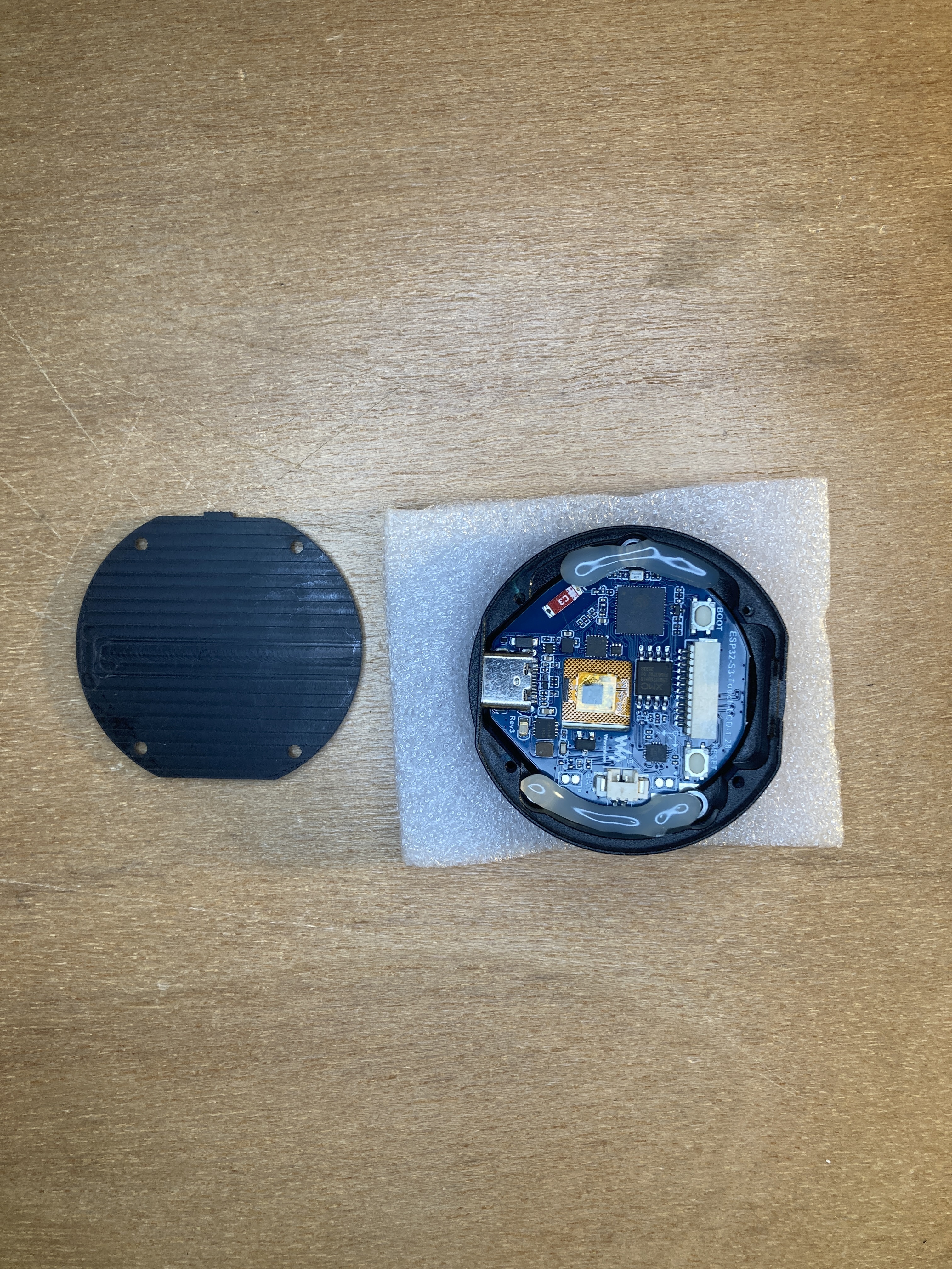

Can you tell me how this product’s case works?
Is there a hole or connector exposed by the case that allows you to connect the battery?
Hey @Pixmusix,
Well, this one they actually want you to open judging by the included screwdriver.
This one is powered via a 1.25mm pitch Molex cable. There’s not exactly much room inside, but you should be able to connect a very small lipo in there, provided you can get one with the right connector.
But as you can see there’s not exactly a slot for the battery either. With a little bit of double-sided tape you could probably affix the battery to the interior of the case.

I don’t think I have the tools to figure out if any given battery would be safe inside the case or if it some component would be squishing it in a dangerous way.

If you have to print up a case could you not make provision for a LiPo OUTSIDE this case but INSIDE the one you need to design. You would have to arrange for the wires to exit the device case to connect the battery but the one you linked seems to have provision for a cable to exit so might be UK.
