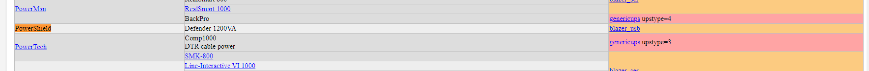

To secure this against power outages I would like to run this from a UPS. I am looking to run Network UPS Tools (NUT) on the Pi to manage a clean shutdown if required. So the UPS needs to be able to signal the Pi and be NUT compatible.
I note you have the PSD650 UPS 650VA Defender UPS that is about the size I am lookin for. Brfore I buy, can you please clarify the following for me:
Is the PSD65 UPS compatible with Network UPS Tools (NUT)
Can I put a powerboard into one of the poser outlets to power the two SATA drives?
You might want to check whether the PowerShield software will run on a Pi, as it’s available on Linux
