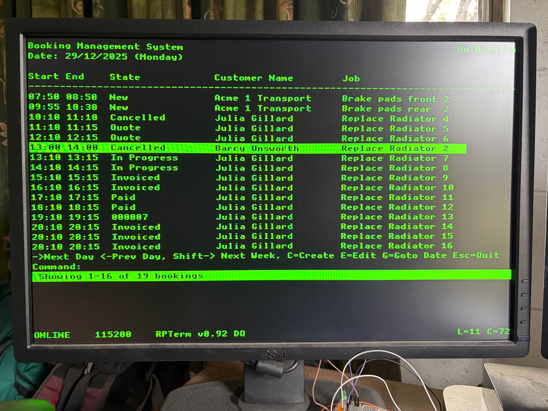

You don’t need the pico W (wifi version) as FUZIX does not currently recognise wifi but it doesn’t hurt either. I have also pictured my VGA Demo Board which again is optional.
Note: ON the pico VGA demo board I had to face the first 6 pins upwards instead of downwards as the vga demo board didn’t allow for a UART connection. I just stole the pins (used for red I think) for the UART serial connection. I only needed one colour for the demo and I programmed it for green in my application.
Here is an example screen on the VGA Demo board.
Here is an example of the regular console screen.
