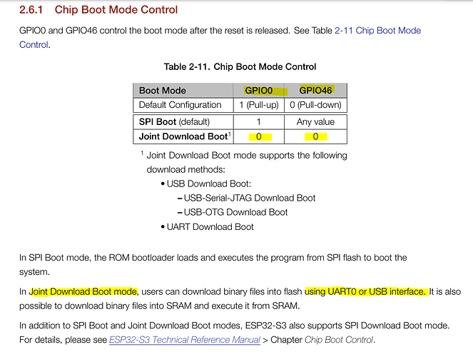

Base on where i see the “dot” on the ESP32 chip in that image, I rotated his to match.
Since there is a USB HUB and then a USB for the RP and one for the ESP32, I would expect to see an serial port show up for each.
Normally the Enable/Reset and GPIO0 are connected to some little bit of circuit such that the pins or set via the RS232 pins. If that was done, you should not need to hold any buttons etc.
What Im not sure of is whats wired up as there is 2 ways to upload firmware (that I can see)
So a little checking may be needed to find if its the built in or the UART that is wired up.

@Michael99645 The S3 and other new variants have the USB peripheral connected to that similar reset circuit internally, allowing USB flash to happen without having to press and hold the boot button, pretty cool since Thonny also includes all variants - ESP32 + Micropython is super accessible (though when passing through onboard USB Hubs this can throw a spanner in the works)
