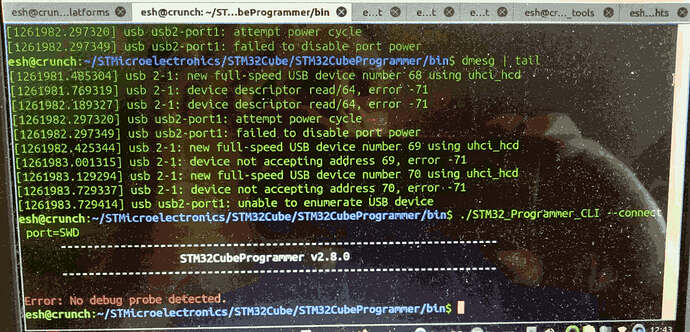

After some refactoring of the code, I tried to download revised firmware, but the debug output showed that the programmer could not be found. No connections had changed, nothing had been unplugged.
I tried unplugging and replugging the ST-Link, but it could not be detected by the OS.
I have tried plugging it into another machine, and get the same sorts of errors, namely
“[ 3200.114079] usb 1-1: new full-speed USB device number 32 using xhci_hcd
[ 3200.114306] usb 1-1: Device not responding to setup address.
[ 3200.322026] usb 1-1: Device not responding to setup address.
[ 3200.530018] usb 1-1: device not accepting address 32, error -71
[ 3200.530272] usb usb1-port1: unable to enumerate USB device”
