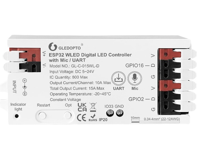

WS2805 LEDs have arrived and they have 4 wires; red, green, blue and white. Now I’m assuming that’s because one is the CCT.
When I looked at the controller it just has two lots of connections for G, D, T … did I buy the wrong controller and need something that allowes for 4pin? head slap
Or can both green and blue be put into the same data connection?
Hey @Dave281205, COuld you share a photo of the controller and the strips?
They should be somewhat labelled with what each pin does but it would help being able to see to help identify whats going on.
Attached, thanks.
