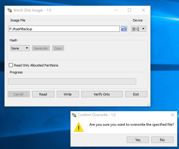

I have been playing with Win32 Disk Imager after my previous comment.
I am happy that it will back up my Pi SD cards, which is a much better option than tying to duplicate a documented process.
I note on both your screen shots Read Write & Verify Only are enabled.
This only occurs for me when the file I want to backup to already exists.
Check that the file has not already been created, or try a different name as suggested by Arnold.
It is always good to use the file extension so the system knows what type of file it is.
Or you have typed the name and it is pointing to a directory, I tried this and it produces the same error.
If you click on the folder icon to the right it makes you specify a name.
