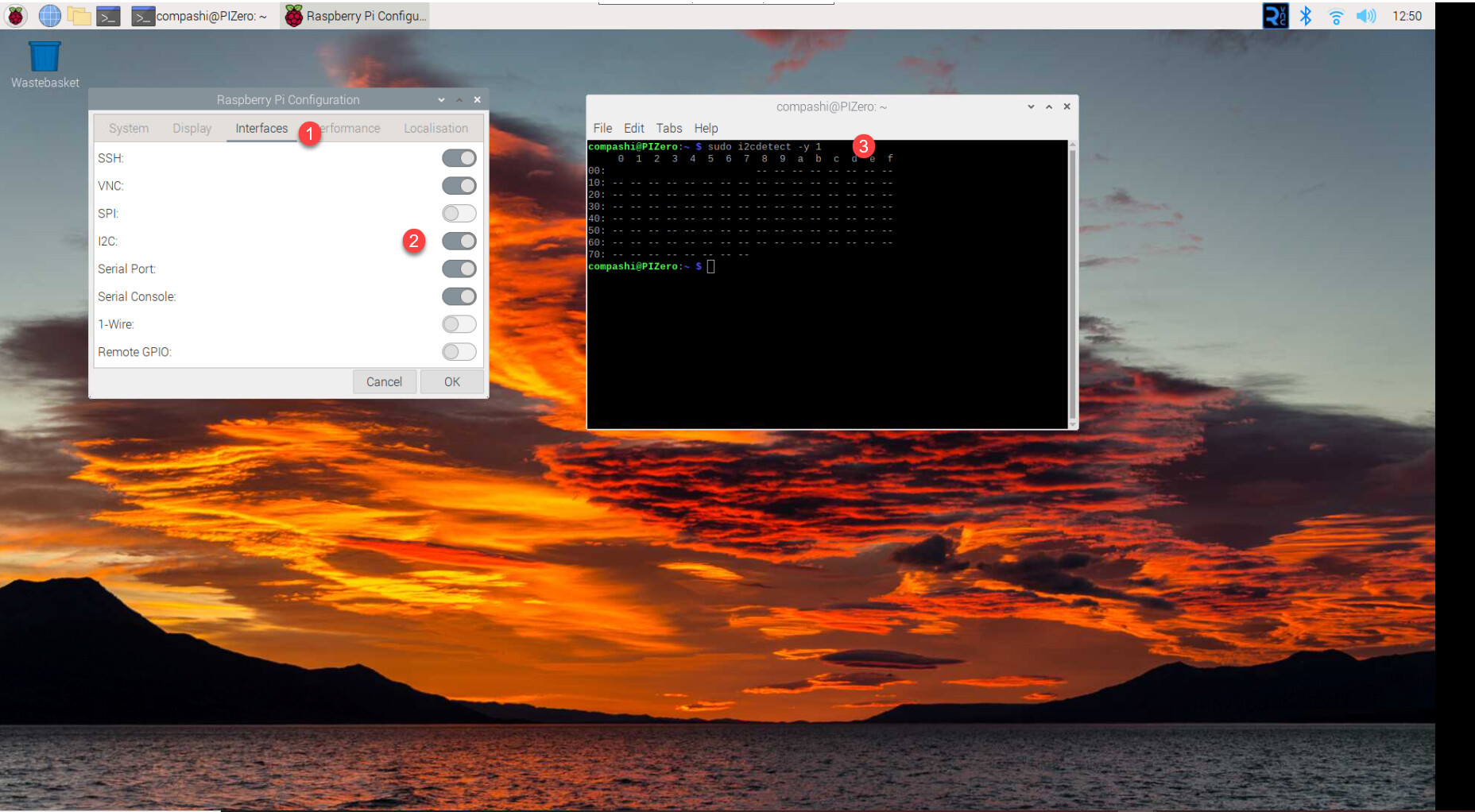

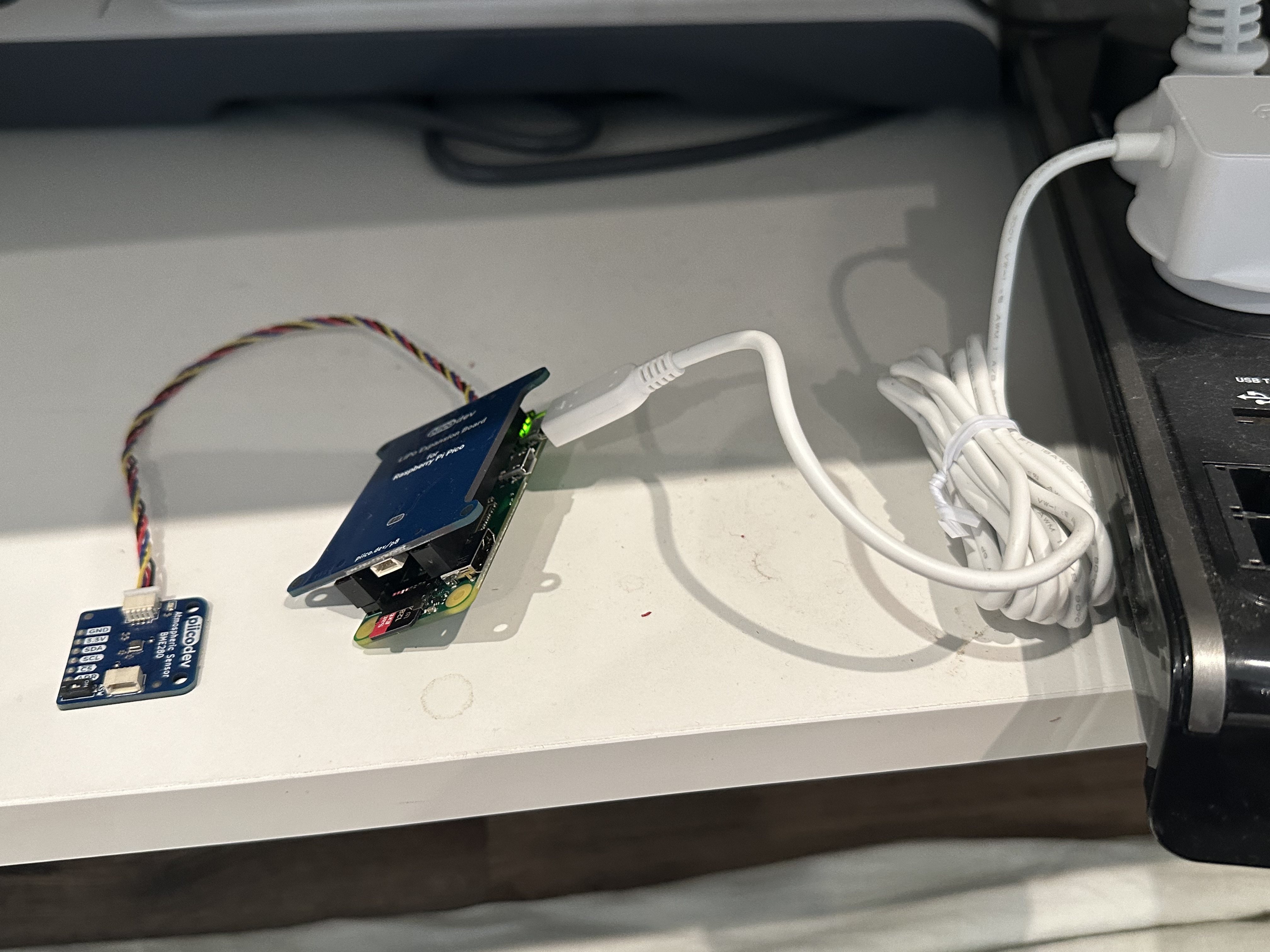

Hello Michael,
Referring to the guide
https://core-electronics.com.au/guides/piicodev-connection-guide/#UDWHN0C
i find difference as the Raspberry PI W layout dont looks same,
i am trying to setup BME280 sensor but this time with Raspberry PI Zero, few things i can see
there is no light blinking in BME280 and also its not detected on terminal once i run sudo i2cdetect -y 1
i have already enabled I2C on setup,
Can you please vet my connections and let me know what is wrong here or if anything else needs to be checked,
