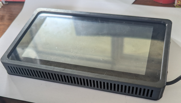

Of course a 3D printed case for the Waveshare and Pi Zero can be handy. The zip file contains photos, STL files and the Openscad scad file. There is a comments section at the start of the scad file
waveshare7pi2wcase.zip (1010.1 KB)
I’ve 3D printed a case for the display/Pi and posted a photo plus a zip file with other photos, STL files and the Openscad .scad file. There is a big comments file at the start of the .scad file.
Regards
John

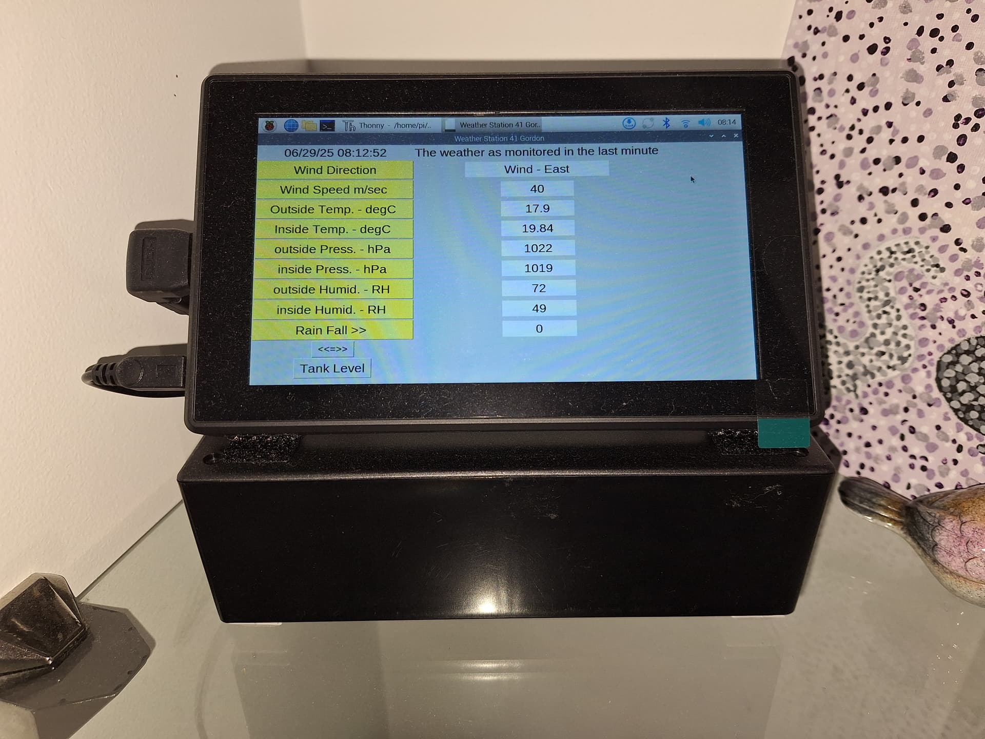

I have used the same Waveshare 7 inch display as my weather station screen,see photo.

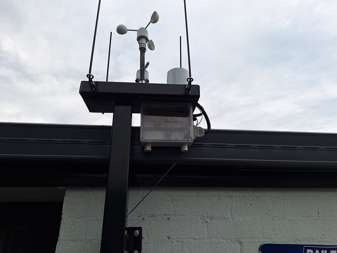

For the project I have used Pi PICO remote weather station external.
The display uses a Pi Zero and the Waveshare 7 inch configured as a desktop.
The display code includes Tkinter as the GUI. In the photo you can actually see at the top the desktop icons.
This arrangement I have found works very well for my application. I update the screen every minute.
There was certainly a massive learning process to get it operating.
May be of interest.
Bryan
Thanks for the feedback Bryan.
You are getting away with using the Desktop because Tkinter is running without the full overhead (just using Xserver) and you only refresh the screen once a minute.
In your case the Desktop is exposed to the user which is probably OK for you but in my case that would lead to grand kids making strange things happen.
I still think you would be better off using Raspberry Lite (no Desktop), installing Xserver for the GUI and automatically starting the Python script that uses Tkinter to display the weather data. I’ve documented how to do that and used my instructions to setup from a new SD card.
However you have a setup that is working fine so why mess with it.
Regards
John
