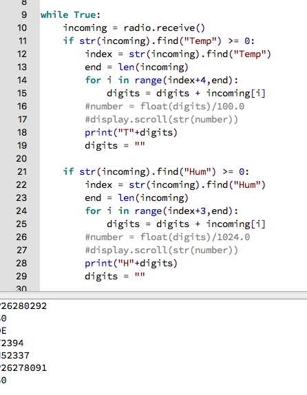

I’ll attach some files to give you some clarity. THe file - Weatherbit micropython garbage shows the output of a BBC Microbit receiving a radio transmission from a BBC Microbit attached to the Weather:bit.
I can’t understand why there are some extra funny characters before the sensor data (Temp, Hum, etc)?
I’ve attached an excerpt of the BBC Microbit transmitter code. The Javascript example code is only for temperature.
IN Python I can easily remove the extra characters, but I was wondering if something in my code was not correct.

HI Graham,
I’ve used this in the past and I tested it again.
Unfortunately all this code does is get bypassed because incoming does contain text based information.
I use this code to manage the gaps in radio transmissions.
I found a workaround. I just use some python code to look for certain key statements that I know will be in the radio transmissions. So I look for the “Temp” keyword in transmittions that contain temperature data. It works well.
