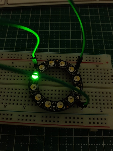

I’m recently new to Arduino and have been playing around with the Neopixel ring (12) this one purchased from your store:
NEOPIXEL RING - 12 X 5050 RGBW LEDS W/ INTEGRATED DRIVERS - COOL WHITE - ~6000K
I can get it to light up but for some reason when coding the colours the GREEN pixels always light up. I also find the green pixels have two lights so the whole ring doesn’t light up. However if i write number of pixels in a sketch and say 16- then does the whole ring light up.

Hi Mitchell, Sure thing.
I am just using the simple example code:

Some points to note :
-I’m using it with a arduino nano
-would it be something to do with RGB / RGBW colour?
I have attached what i hope are clear images.
Thanks Mitchell! !
what happens when i write NUMPIXELS 12 then loops
