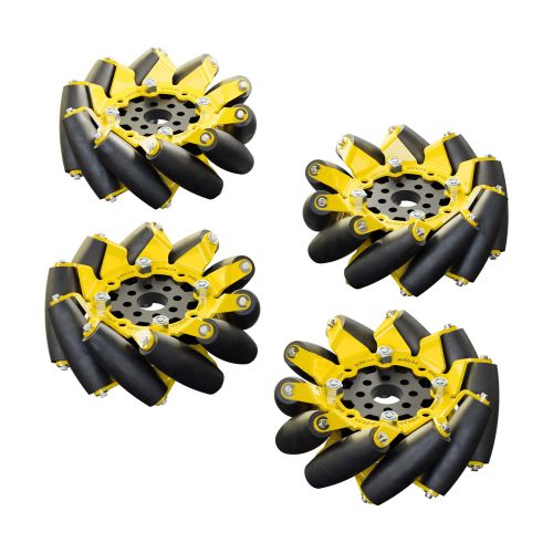

Thank you / Do you have kg load rating for → 96mm Mecanum Wheel Set (70A Durometer Bearing Supported Rollers) SKU: GB-3213-3606-0002 Brand: goBilda

Standard 4 wheel vehicle, load would be 40kg.

I think Jane might need a bit more information to take to GoBilda.
Firstly I think what is your definition of a “standard” 4 wheel vehicle. Could be like comparing a Mini Minor to a Westinghouse rubber tyre Bull Dozer. Both could be regarded as “standard” in their own area of use while being individually vastly different.
For instance are the wheels relying solely on a motor shaft for support , or are the wheels separately supported on the chassis on one side, or are they supported on the chassis on both sides. All possible and would have quite a bearing on what the max load figure for the vehicle was.
Or you might get a load figure for the wheel itself for each individual one disregarding any mounting system which would be left entirely up to you. I don’t see why you can’t get this as it should have nothing to do with GoBilda. If you want to overload a wheel that is your business.
Looking at these wheels I don’t think the max load would be that great. I could be quite wrong but I reckon it would be governed by the weakest part which looking at the pic would seem to be the rollers and their axles and support. I just note the side plates are steel which is somewhat better than plastic but the centre bit looks like plastic which could still be quite strong.
A max load figure for each wheel would be most interesting
All that aside they are a very ingenious drive system for a very manoeuvrable robot vehicle.
Cheers Bob
