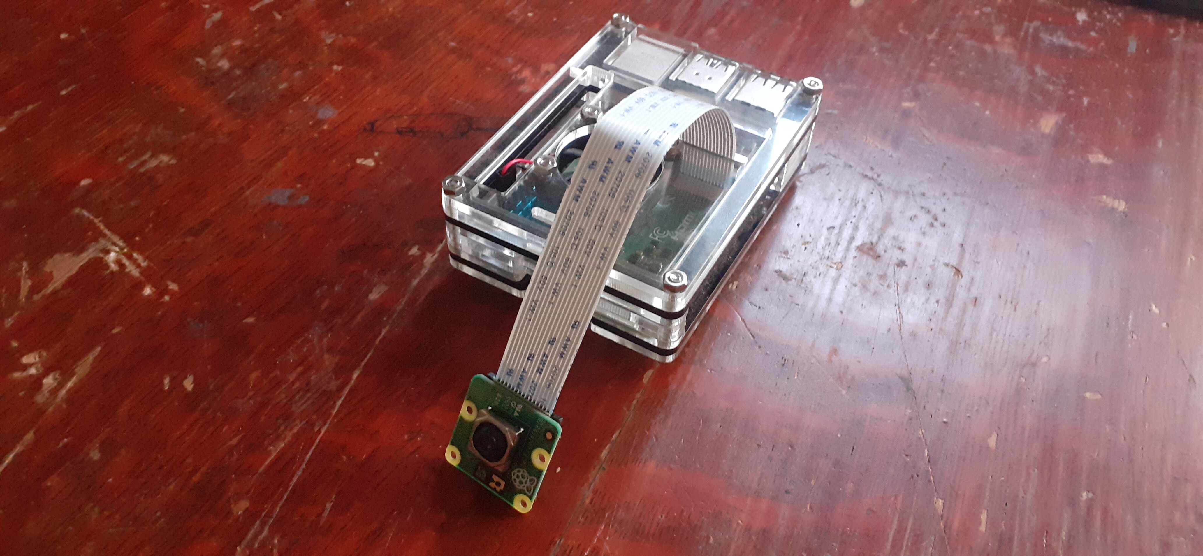

I trust this message finds you well, and I apologize for any inconvenience my inquiry may cause. I am currently encountering an issue with the configuration of Camera Module 3 on my Raspberry Pi 4B. Specifically, when executing the command “libcamera-hello -t0,” I am confronted with the subsequent error message:
Made X/EGL preview window
[0:02:22.195466548] [1248] INFO Camera camera_manager.cpp:297 libcamera v0.0.5+83-bde9b04f
ERROR: *** no cameras available ***
Despite having taken steps to enable the camera on my Raspberry Pi and successfully installing the libcamera-apps package, I find myself unable to resolve this persistent issue. As such, I have taken the liberty of posting this question as a new topic on the Finding Parts forum in the hopes of garnering assistance from the community.

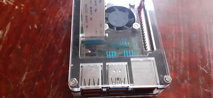

Regarding the camera, could you please send through a photo of how you have everything hooked up?
Have you followed the guide? https://projects.raspberrypi.org/en/projects/getting-started-with-picamera/2
Hi James,
Yes I have followed the steps to setting up my pi as well as doing a fresh install of rasbian yet the error persists, so I have attached images of my pi to this email. Also for the parallel circuits with the HAts what would that look like?
