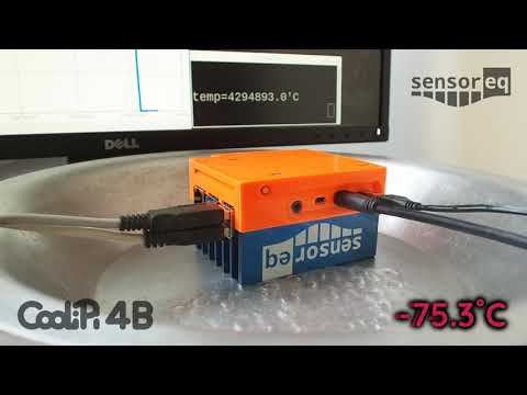

A ferw years back, some guy in Europe posted a video to Youtube of a Pi 3B sitting in a tank of liquid Nitrogen, while overclocked to hell!
This one’s not quite as bad:
