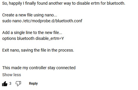

below is the link to fix the Bluetooth Security Bug.
Heres a few screenshots to show you what my Config files look like after the edits.

as with bluetooth I ended up watching several bluetooth videos, and I was about ready to give up until I tackled the issue with a different approach and ended up solving the issue
