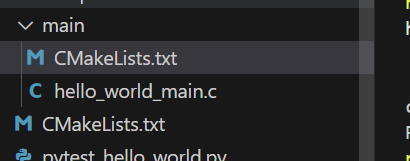

I am not sure how to prevent the formatting above from occurring, so here is an image instead:
What am I doing wrong?
This is the file structure:

Anyways, I am able to see sdkconfig.h in my file structure (6th item in the list below), so the library is definitely installed.

I tried doing that before posting here on the forum, and then the program throws an error on the next line, for #include “freertos/FreeRTOS.h”, and when I pasted that file too in the “main” folder, it threw an error for another #include inside the freeRTOS.h file, and the chain kept going on, until I decided to post here since there’s no way this is what I should be doing.
There are 2 CMakeLists.txt in my folder:
Here is the code for the one outside of main:
