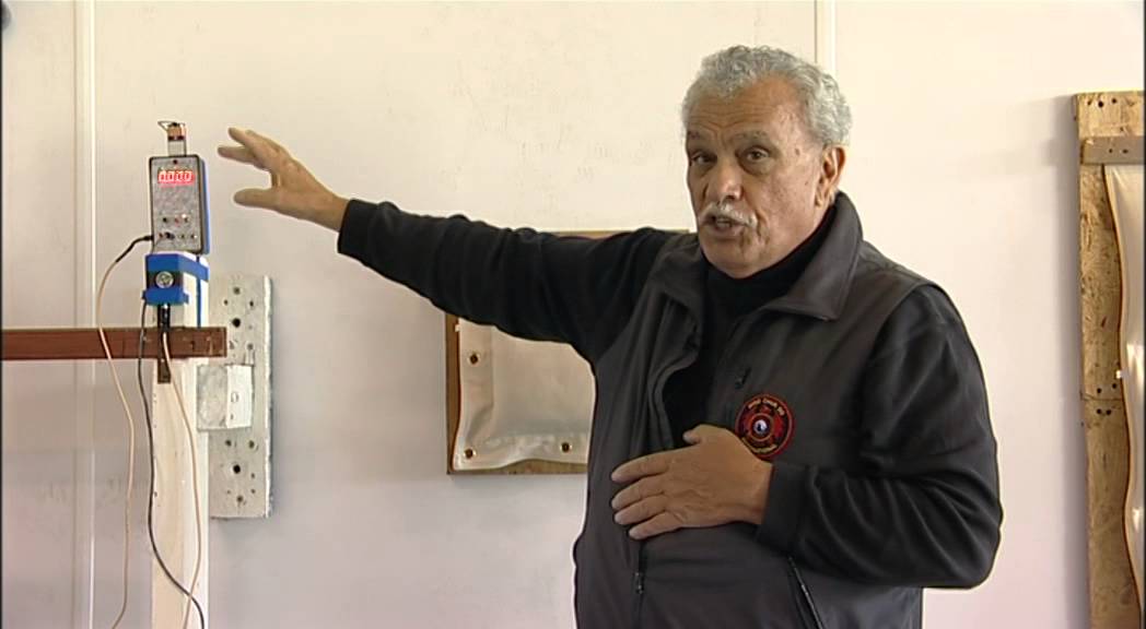

I want to build a combat reflex timer like that shown in this video
Ive found a sparkfun project that almost gives me what I want here
https://learn.sparkfun.com/tutorials/reaction-timer/all
However I’m looking to make the following change
Inside of hitting the button when it lights up to stop the timer I want to be able to hit a sandbag or a focus mitt as in the video above.
what I need help with is:
What materials would I need ( apart from the materials needed for the sparkfun project above) to wire up a switch inside a sand bag or focus mitt to act as the impact point that stops the timer when hit instead of the button. So the only change from the sparkfun project is the impact point to stop the timer is a sandbag/ focus mitt, everything else stays the same.
The material acting as the switch inside the sandbag/focus mitt would have to be able to withstand hard impact punches.

so how do I want everything to work together …basically as in the video…timer is powered on…at a random time light will flash…punch delivered to sandbag/focus mitt…timer stops/shows reaction time…timer resets itself and everything starts again.
