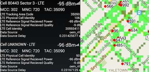

If you’ve got a smartphone, can you install the sim card in your phone let it connect and check the signal strength in your area? Note that this board only has a fairly basic ceramic antenna, and you can improve reception by using an external antenna:
On android, you can also try installing cellmapper:
Or there are some similar handy apps for iOS devices:
