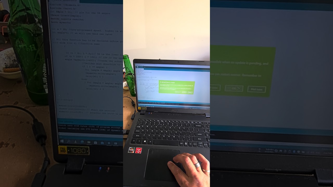

If your interested, here is the end result. Very happy with all the products i’ve purchased from core-electronics and tutorials from here.
