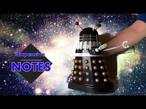

I modified a toy Dalek I was given (its original function was broken) to become a bespoke synth. Here is a demo of it, version 1.
The internals include a Teensy microcontroller and Audio card.

Is the Teensy actually oscillating or is it controlling external synth.
They only thing not coming from the Dalek (Teensy) is a bit of reverb from Logic Pro. Although I could add reverb internally.

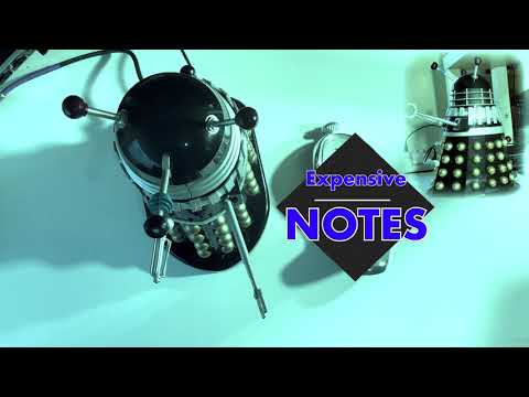

Here is a demo of version 3, with more polyrhythms. Okay, so it is probably Poly-meters rather than PolyRhythms. All the three main sequences have different length patterns which you can see evolving on the OLED screen. I even did some manual “sequencing” on the buttons, if you could call it that.
The jam Includes an arm Malfunction, Davros would not be happy!
