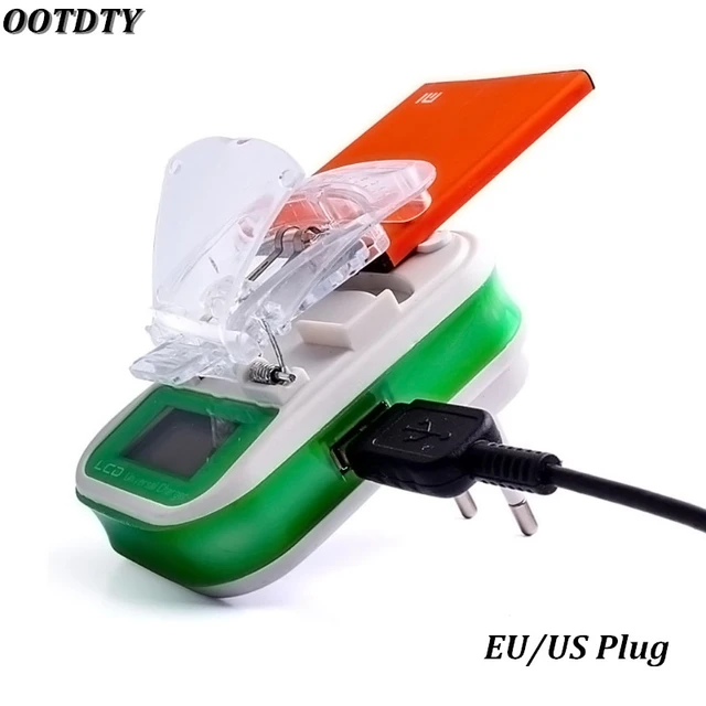

I would also like to charge this battery with one of these chargers but I don’t know which adapter to buy

Looking at the battery you have it appears to be similar to ones that we sell on our website Polymer Lithium Ion Battery (LiPo) 3.7V 1100mAh | Core Electronics Australia, you should be able to to remove it from the JST housing and probe the exposed metal pins on the connector. As for a charger our Makerverse USB-C LiPo Charger | Core Electronics Australia should be able to charge it via USB C

tell me a decent charger model for this battery on Aliexpress
