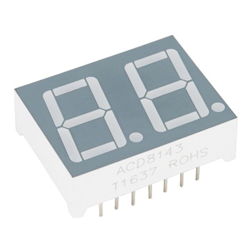

is each segment able to be set independly so each segment can be any of 7 colours ( not including black) or do all segments need to be the same colour or is it each digit can be its own colour? from my limited knowledge reading the deta sheet I think it’s each digit can be one colour I would prefer each segment
Hi Kiera,
Yeah, each segment can be controlled independently - and each channel RGB can be PWM’ed to make much more than just 7 colours!
Its a shame there isnt a dedicated breakout for this part, driving it correctly (with absolute best practice) would be somewhat involved, but getting an MVP solution should be pretty straightforward.
A board like this ought to give a good head start: Adafruit AW9523 GPIO Expander and LED Driver Breakout - STEMMA QT / Qwiic | Buy in Australia | ADA4886 | Core Electronics
Or a bit more advanced: Adafruit 16x9 Charlieplexed PWM LED Matrix Driver - IS31FL3731 | Buy in Australia | ADA2946 | Core Electronics
Happy to discuss any further questions you might have!
