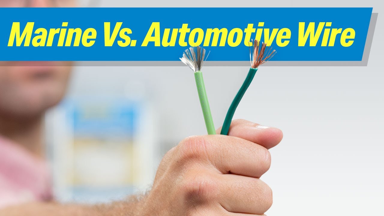

Serious “Marine grade” cable us usually lead sheathed or SWA (Steel Wire Armoured).
I don’t mean anything inudstrial like undersea cable, cargo ship or oil rig stuff, just ordinary marine grade you can get from any hardware store.
It has a higher strand count, it’s fully tinned, and it’s got extra flexible insulation that’s more resilient to various environmental factors (chemical and UV exposure mainly).

Hi Oliver
Yes I did mean “serious” like what you would find on a ship or larger vessels where damage can easily occur.
Re that video, I honestly have never seen cable advertised like that as if “Marine Grade” was something super special. Looks to me like a bit of shrewd marketing. My not noticing might be because I have never looked, I don’t have a boat so tend to just walk past boat shops unless I want something special in the stainless department.
We (by "We I mean my employer) tended to purchase cable and wire as an item which would do the job or met laid down specifications. Never knew if it was “marine grade” or not and didn’t much care. We used Hartland quite often as if something out of the ordinary was required like double screening which may not be a stock line for a particular size they would make it for us by just putting an extra screen on during a production run. I personally go for tinned wire unless I have no other alternative. I still have a bit of Kynar wire left over which is silver plated. As a general rule I like 0.2mm stranding but if I need more flexibility I try for 0.1mm which are both common. If greater flexibility or temperature rating needed I would look at silicon sheathed wire.
