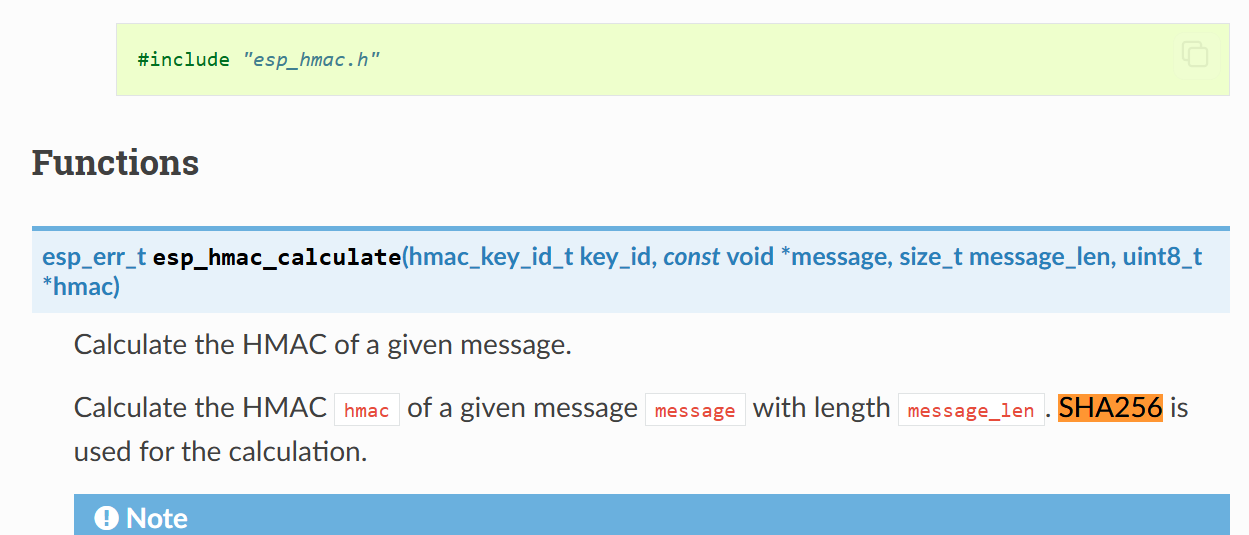

Without digging too deep, There should be something in the core ESP32 code as sha256 would be needed for some SSL (https) checks, So if you have HTTPD (or any other SSL running, then the code will already be somewhere to call.
Edit:
have a gloss over this
OK, after some reading and playing, looks like the ESP32 IDF (and I saw a referece to arduino as well) is using the mbedtls for SSL opterations. In that there is hashing options with one being SHA256.
I found this code worked for me in the idf (as a quick hard coded example) and a nice write up as well…
