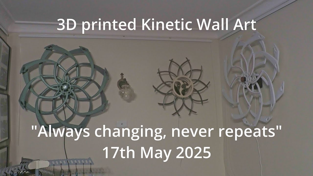

Kinetic Wall Art video now up
All 3 Kinetic Wall Art items up and going together for the first time today!

That looks so cool!
What does your motor setup look like for the green one that has spins in both directions at once. Are you using two motors for this or some kind of gear setup to spin them both from a single motor?
Thanks! Using 2 motors so can drive the arms independently.. each motor with bevel gear on each hub and sharing a common hollow shaft for support and wiring. Detailed pics in related post will show you the layout
Very cool!
Much more functional and less complicated than using one motor for both with a gear system to flip the rotation direction.
