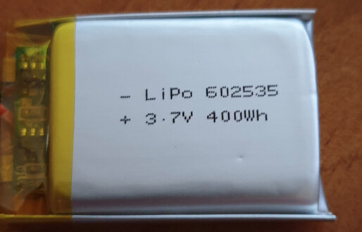

I ordered some of these ( Polymer Lithium Ion Battery (LiPo) 3.7V 400mAh | Buy in Australia | CE04375 | Core Electronics ) which state 400mAh which I assume to be correct; that said, printed on the battery is what seems to be 400wh, So I will assume what is printed is wrong as 400 whr/3.7v = 108A hr, which would be damn good for such a small package.
Ok, that miss-print aside, I wanted to confirm the charge rate. My understanding is the “safest” way to charge LiPo is @ 1C, where 1 C = the Amp/hr of the pack. So if this is 400mA/hr, then it will be very safe to charge at 400mA ? Is the correct ?

Ahhh yeah 400Wh is waay too good to be true.
Yeah 1C would be fine, anything under is a bit safer.
Those pouch cells dont have a BMS persay, rather a PCM (Protection Circuit Module).
A BMS keeps the battery healthy, usually programmable meaning you can set a shut-off value to not damage the cells.
A PCM on the otherhand protects everything else (except the health of the battery). It will cut out well below the recommended voltage to prevent anything dangerous happening like fires.
In theory charging them, yes - but as with any LiPo it would be worth supervising them while they charge (in a LiPo bag)
