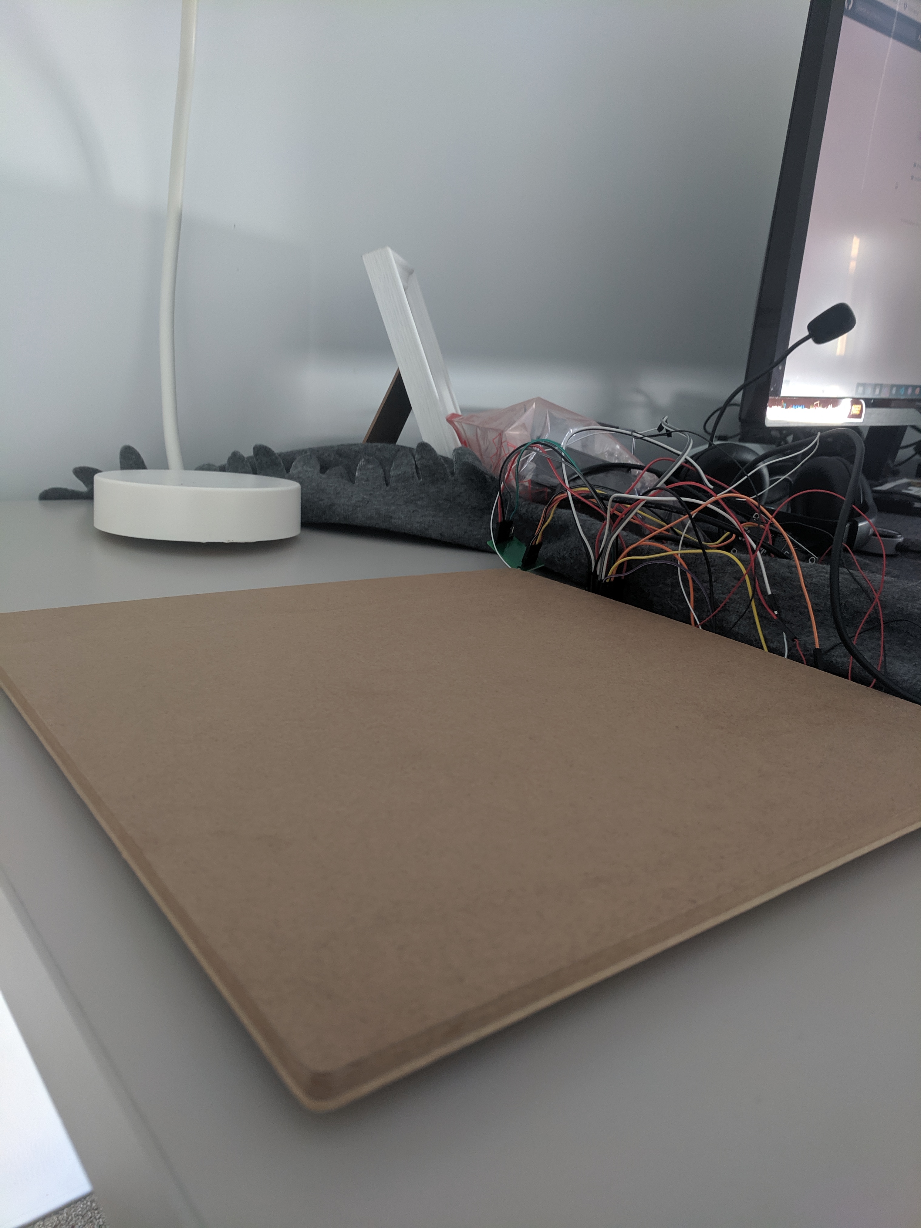

Do you have a picture of how you mounted the cells?
The scales I’ve seen with a load cell are pretty sturdy metal frames, and bathroom scales are nearly always glass as it’s the most elastic. Not bendy or springy- elastic.
I’m guessing things are moving a touch from where they were setup hence the changing readings?
Yes.
Load cells are just placed on the table and I am using a plywood over on top of them. Please see the pictures.
Thanks for replying.
Just guessing, but I reckon your table could be flexing.
Try putting a support under the table?
I will try. I let you know. Thanks.
