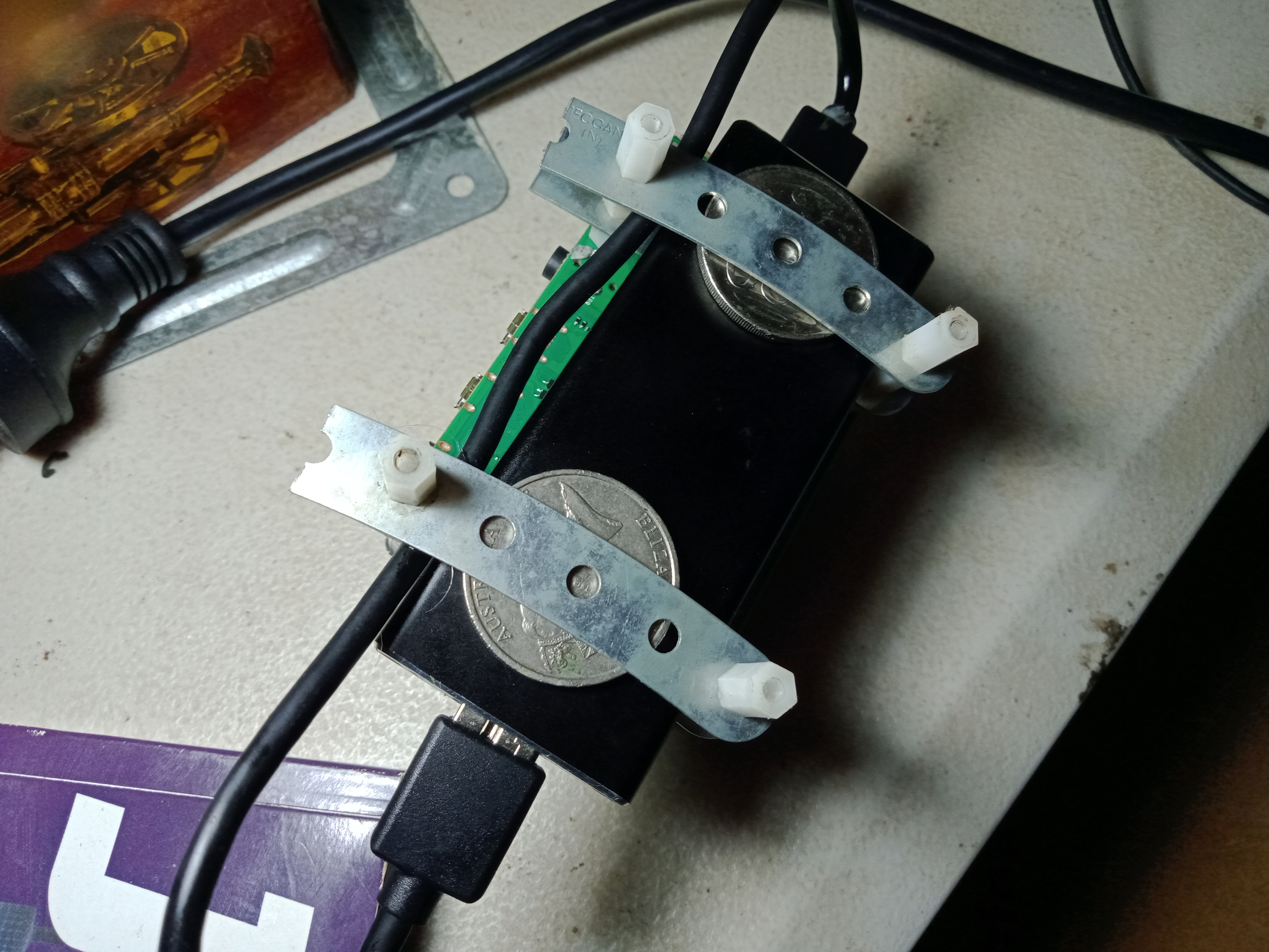

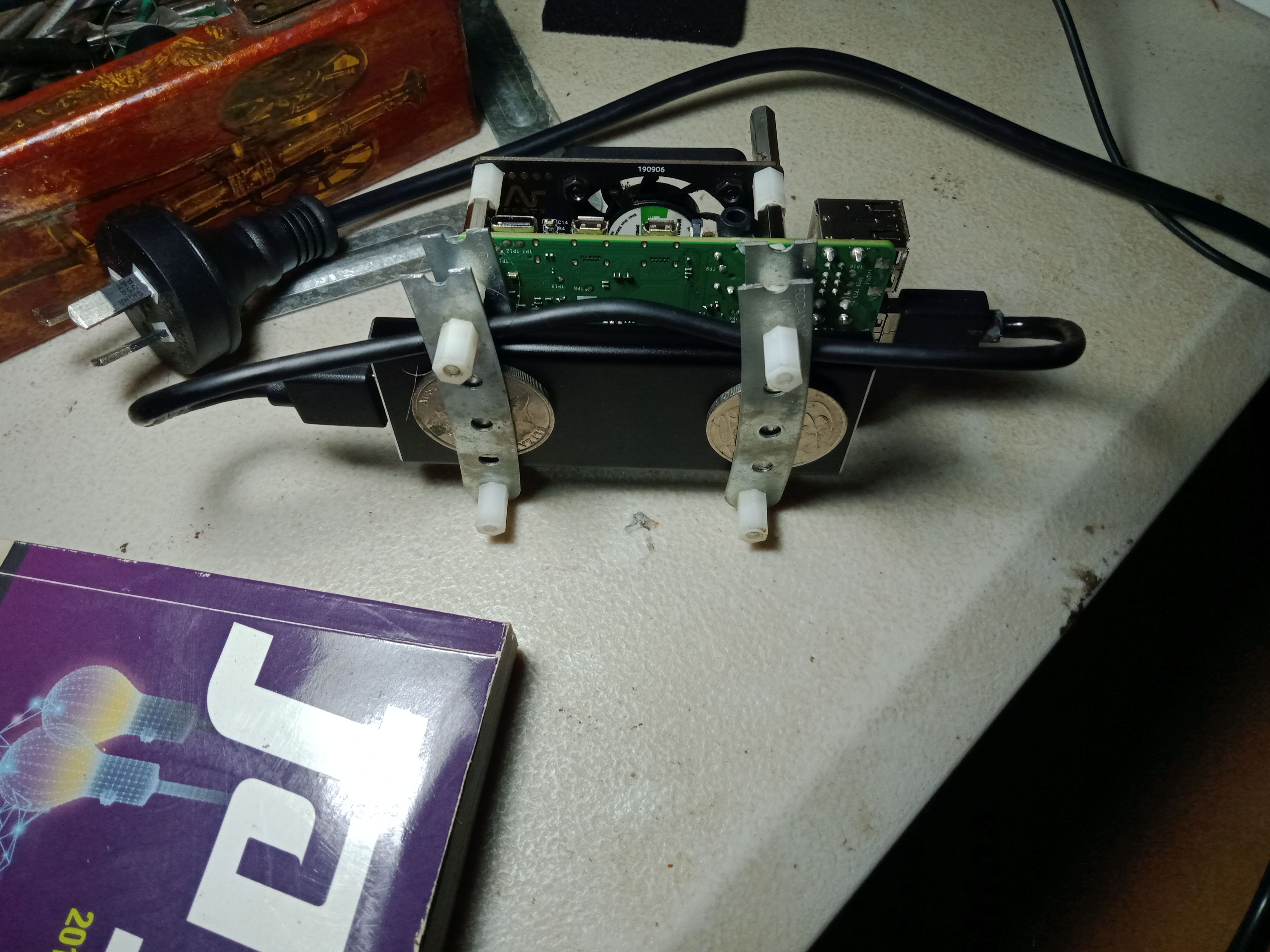

some pics of my RPI-4.4Gthis is my m2 sata 120GB hdd and my argon one fan hat and the flat corrugated heatsink…i found some old mechano laying around and some 20 cent coins…its not the prettiest in the worl but its fast at 2250Mhz ans the m2 sata to usb bridge j.i boots in seconds to the desktop…it has a …wd green inside…so a black would be my next buy…for storage i think.the usb cable just sat that way but normally sits true…it runs 20-10 Ubuntu argon one hatr runs ok if you don’t mind the command line interface…i have a modded file that puts the icons on the desktop but it needs more work as the icons are not responsive…due to the lack of …“rpi-config” not being a Ubuntu repo…etc… but the cmd-line will give you all the fan adjustments after running "argon1.sh and then inputting your temps…fan trip points …the switch is responsive to only 2 functions reboot …hit the button 2 times in 2 seconds or shutdown hold it for about 3 seconds,…,its done a lot of miles at 2 ghz i only started over the 2K mark in the past few weeks i want to put a water cooler on it ive seen them but not at core ..i would rather give core my money so as soon as i can im stepping up to this cooler…also i have a 4 amp supply on it and i don’t know if it is of any advantage i am also going to feed 5 volts into the GPO-power pins…oh as well i drilled out my corner mounting holes on all my rpi boards…main reason is that the other sbc`s boards i have used have used in the past have all been M-3 style boards… so i have an abundance of N3 hardware…if your going to go with using m3 holes into the rpi boards then …my advice is check around the corners or where the holes are located…check to see if any tracks are really close to the holes firstly…if your not shore shine a 15 watt fluro cfl desk lamp between the board and your eyesight…or underneath the board etc,etc,…it should show up the tracks as you should be able to see through the board in an opaque sort of way but the tracks will be dark lines.the painted lines will most likely show but you should be able to tell the difference,

Very interesting, I really like the coin based spacers between your SSD and the Mechano, could you try running Stressberry and putting up some pictures of your output? I’m curious to see how much of an increase in performance there is when improving the cooling.
@2200 it hits 71 in about 5 min and then stays there for the duration i had to do it all in a terminal the test lasted 30 mins it was the first one i ever did but there you go i dont have anuy gui knot knowing what exactly to load to graph it…??
